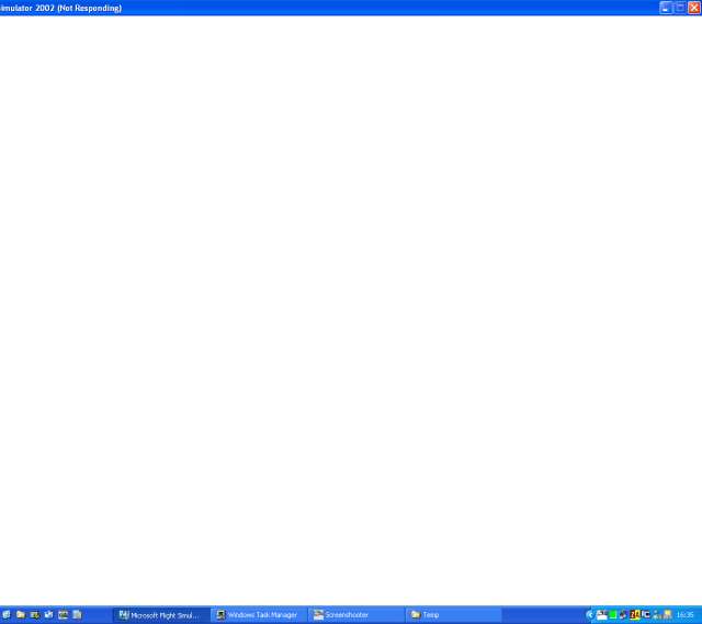

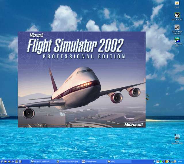

I need some assistance ;After some testing and manipulations in "NView" coming with the Nvidia products. When I activate FS the game starts(large window with the logo) and short after the window minimizes automatically ; when it is minimized in the task bar the lonely option
available is "close alt+F4", all the other options are not accessible , they are visible but in gray colour and cannot be selected. When check via the Task Manager: FS is running 97% of the CPU ,only a few I/O are visible.
How can I get back the default options and avoid this automatic minimize?
Thanks in advance
BTW this happens only with FS2002, I do not have this with any other program.
I am testing Nview because I have now 2 screens on my GF4 TI4600
I did add the screen shots to show the case
Screen 0 is what it should be , what it was previously
Screen 2 is what I have now ( the same start image BUT in a window!!)
Screen 1 is what I have (sometimes not always, most of the time there is no reaction to my request)after the automatic minimize and when I try to maximize the window again , there we can see in the top "not responding"
and it stays so until I close it ...
Sometimes I get the "select flight" window (after 10 to 15 minutes) but again when I select the aircraft (or an other option) the window minimizes.

I have a GF4 TI4600 the 2 monitors are attached to this card. Nview is now disabled and the screen shots were taken when NView was disabled. I did retry with Nview enabled and I have the same bad result except that there is the Nview Icon in the title bar when FS starts, after a few seconds this NView icon disapears from the window Title Bar , I just found that I can move the FS window to the screen 1 (it is totally blank with FS 2002 in the title Bar) the logo stays on the screen 2 and nothing happens, I can minimize , maximize the window but the application is stuck.
I made a screen shot to show , the screenshot is uploaded (on the left you see the FS window totally blank, behind it VPC window while I replay and in this window in the Title Bar right you see the Nview icon; O the right you see the application logo) .
Last news I did receive the FS select flight window (screen shot uploaded) as soon as I select a flight and "fly now" the FS window minimizes and when maximized the window is totally blank.
But the FS is stuck.
